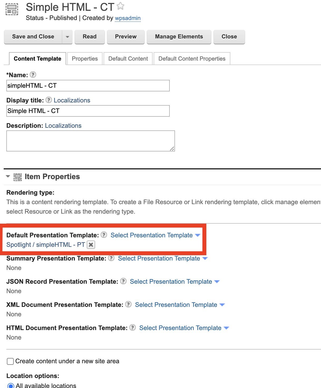

  5. Create a Content Template.
    1. In your library, click New > Authoring Template > Content Template.
    2. Under Name, enter the name of your content template.
    3. Click Manage Elements.
    4. Under Element type, select HTML from the dropdown.
    5. Under Name, enter the name of your element, then click OK.
    6. In Default Presentation Template, click Select Presentation Template.
    7. Select the Presentation Template you created in step 4, then click OK.
    8. Click Save and Close.
    default presentation template

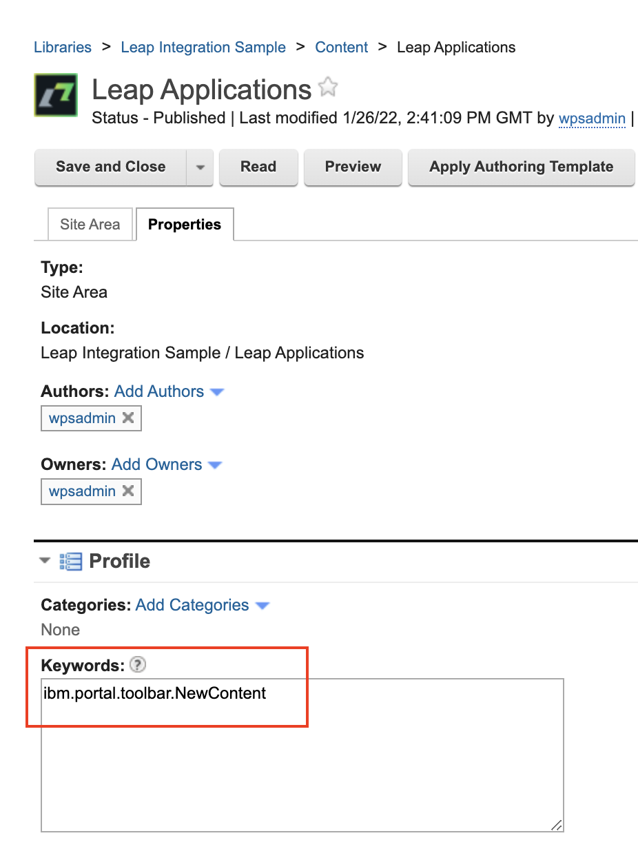

  6. Create a Site Area using the default template.
    1. In your library, click New > Site Area > Default Site Area Template.
    2. Under Name, enter the name of your site area.
    3. Click Properties > Profile.
    4. Under Keywords, add the following parameter to make your site area is visible when in your DX site's Edit Mode.
      ibm.portal.toolbar.NewContent
    5. Click Save and Close.
    keyword property

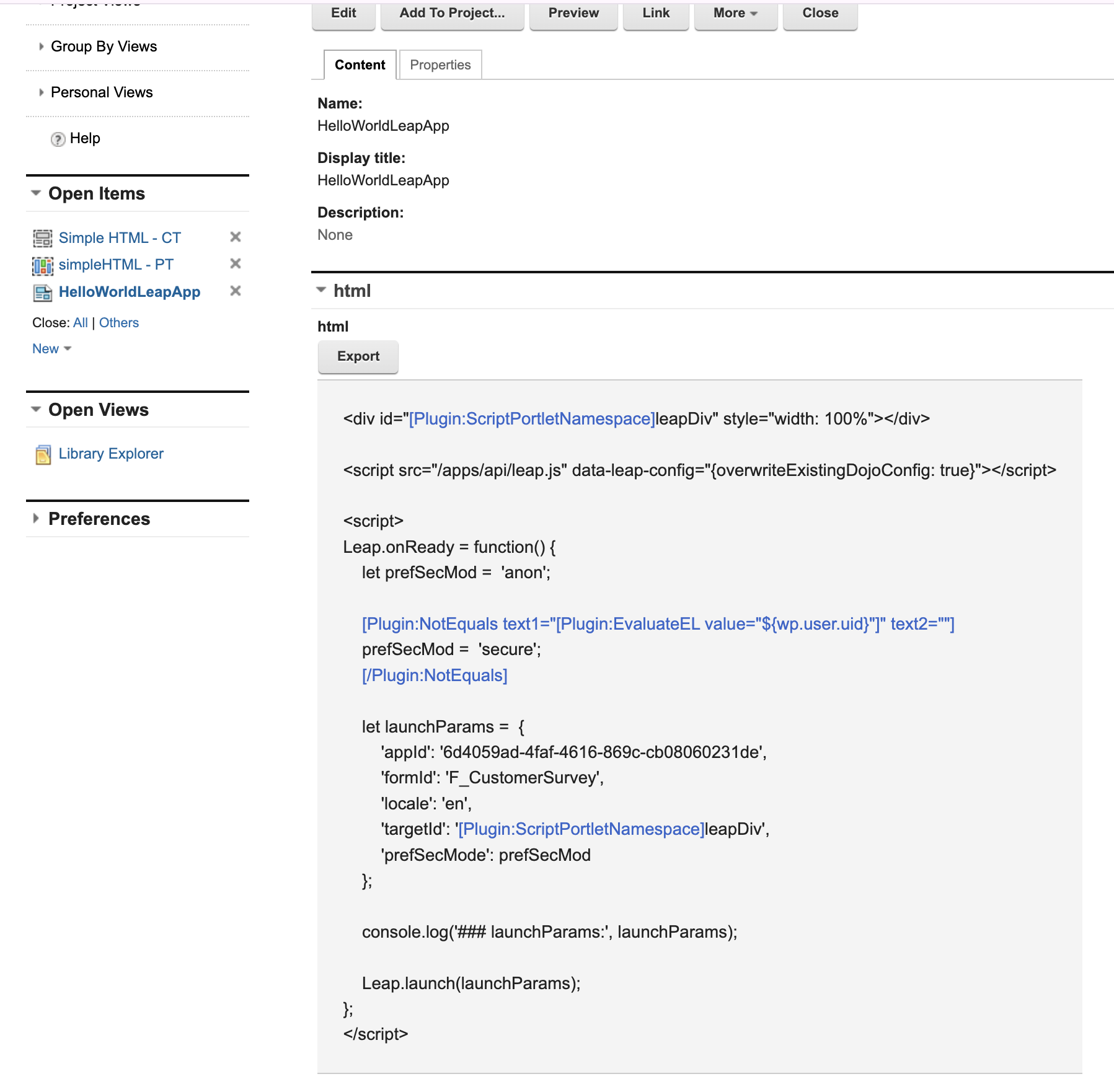

  7. Create the Content based on your content template.
    1. In your library, click Content.
    2. You should see the site area you created. Click on it.
    3. Inside your site area, click New > Content and select the content template you previously created.
    4. Under Name, enter the name of your site area.
    5. Open Leap in a different tab and get the Launch link for your app.
    6. Compare your Launch link to the pattern sample-hostname.com/.../app/<appId>/launch/index.html?form=<formId>, and note your appId and formId. That is, your appId should come after the word "app" in your link, whereas the formId should come after "form=".
    7. Go back to the Content you're creating. Under html, paste the script below:
    <div id="[Plugin:ScriptPortletNamespace]leapDiv" style="width: 100%"></div>
    <script src="/apps/api/leap.js" data-leap-config="{overwriteExistingDojoConfig: true}"></script>
    <script>
    Leap.onReady = function() {
        let prefSecMod =  'anon';
        [Plugin:NotEquals text1="[Plugin:EvaluateEL value="${wp.user.uid}"]" text2=""]
        prefSecMod =  'secure';
        [/Plugin:NotEquals]
        let launchParams =  {
            'appId': '{appId}',
            'formId': '{formId}',
            'locale': navigator.language,
            'targetId': '[Plugin:ScriptPortletNamespace]leapDiv',
            'prefSecMode': prefSecMod
        console.log('### launchParams:', launchParams);
        Leap.launch(launchParams);
    </script>
    1. In the script you pasted, replace {appId} and {formId} with the appId and formId you obtained from your Launch link.
    appId and formId
